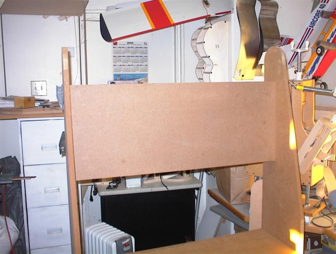

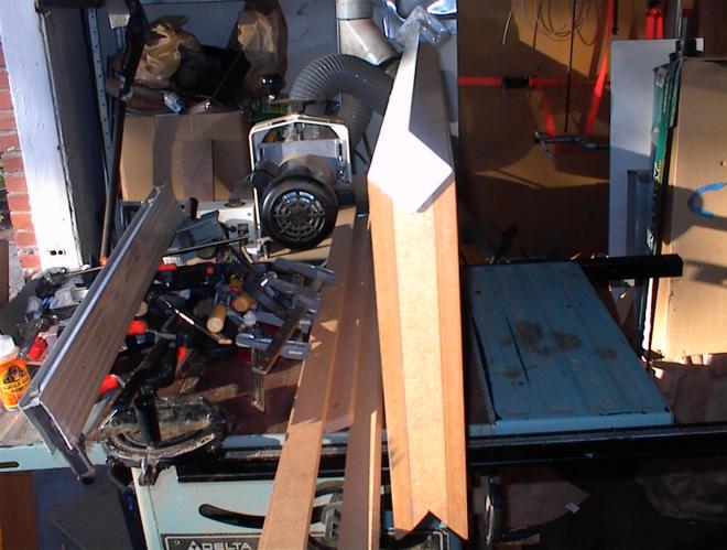

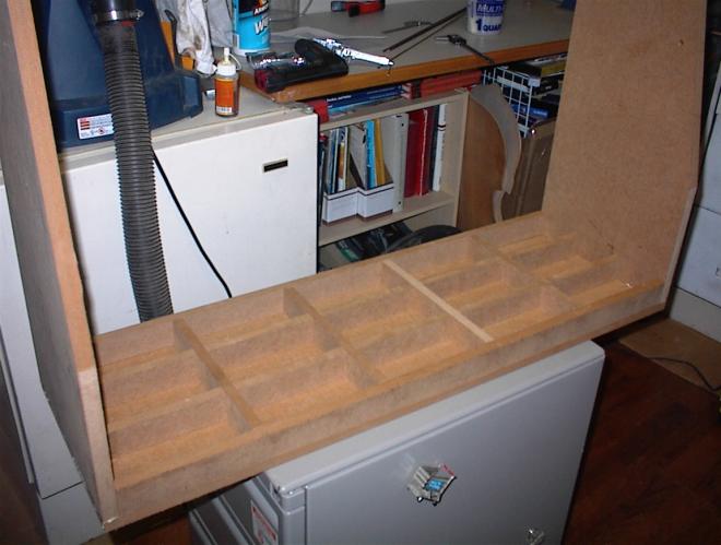

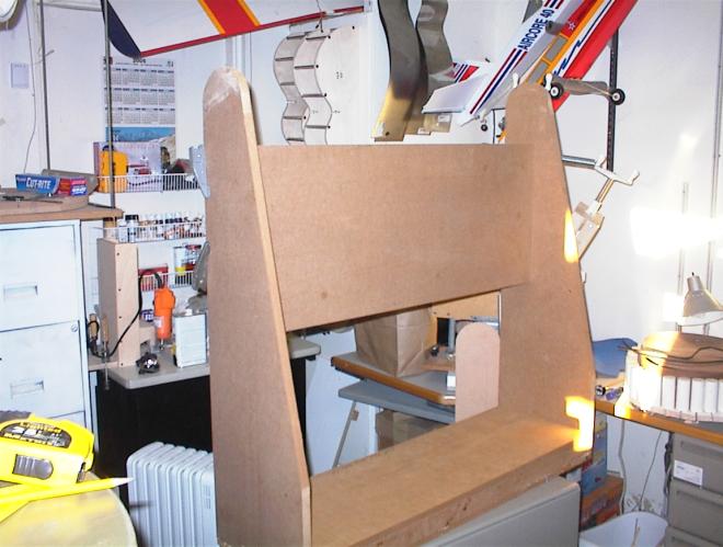

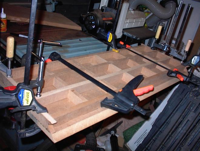

Here are some picture of what I've don so far. Here is a picture of the gantry without the bridge and with the lower torsion box minus it's cover.
Here is a picture of the bridge torsion box under construction.
bridge section complete.
PostPosted: Thu Nov 03, 2005 12:02 pm
Posts: 299
Heres a picture of a test fit of the upper bridge rail.
And finally a couple of pictures of the bridge being test fitted on the gantry.
PostPosted: Thu Nov 03, 2005 12:06 pm
Posts: 299
Now I have to wait on the bearings and rod before I can do more. Everything so far is level and square. Also, the sides seem to be very rigid but I still might add some stiffeners for good measure. Right now I'm going to seal everything and paint it with a nice arcrylic enamel. If you see an area that I can improve on as I go along feel free to give constructive criticism.
